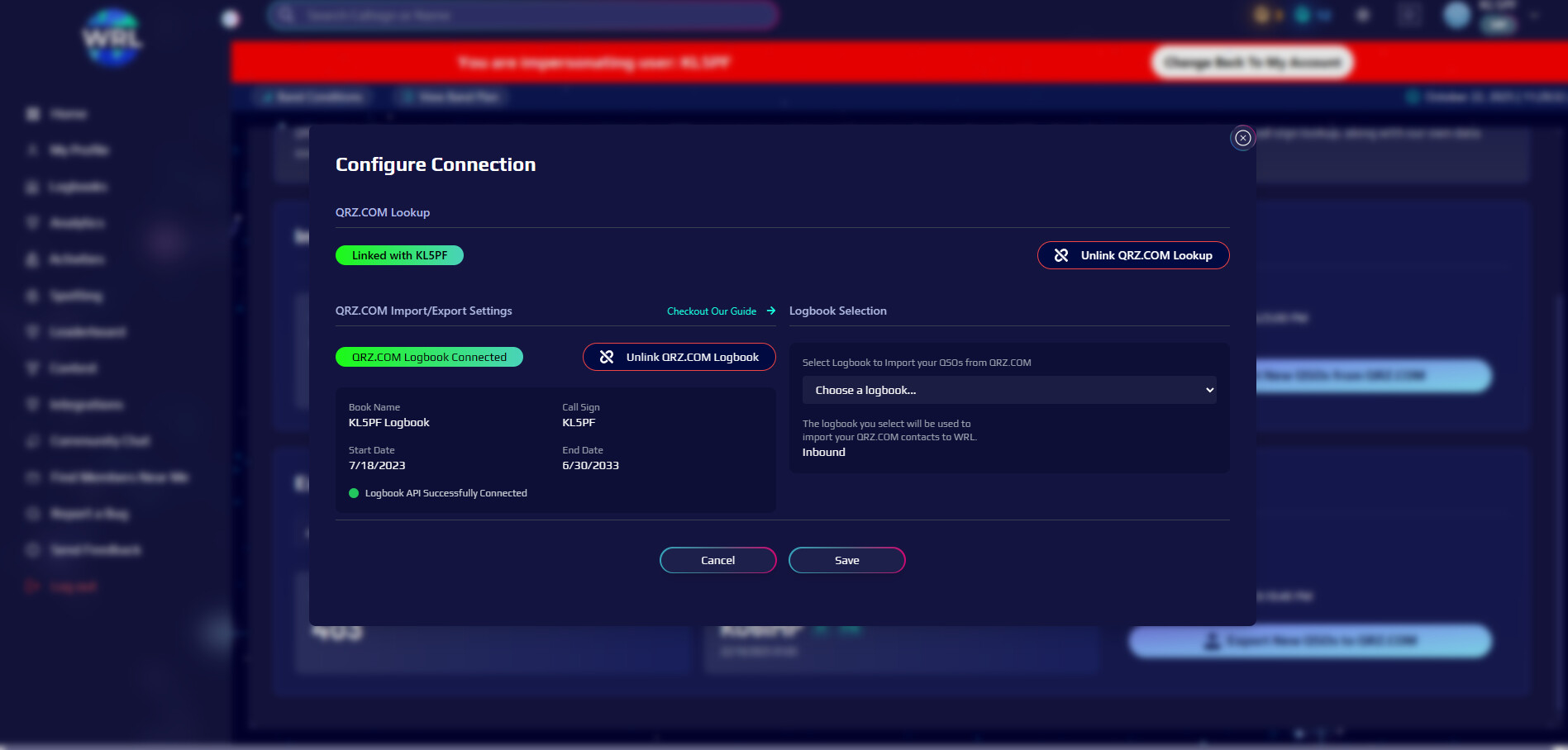

@K4AZE I have done the Shift/Refresh each time with no changes. Furthermore, I have cleared my Cache on the Google browser on my M4 macOS 26.1 Beta (25B5072a)), disconnected, and reconnected from QRZ. Imports work fine. Exports only work with singles, not in a batch. Any suggestions?
@KL5PF I just checked your account, it looks like you dont have a WRL logbook selected from the dropdown for the export section, whereas you do for the import (WRL logbook called inbound).
Goto the integrations page and click the green button that says ‘Linked with KL5PF Logbook’ and select a WRL logbook you want to export from and then click save. Then make sure to click the ‘Auto Export’ toggle.
When I follow your instructions and click on import, the dropdown menu only shows you import options, not any export options. I did all the prior steps just to make sure I did not miss anything.

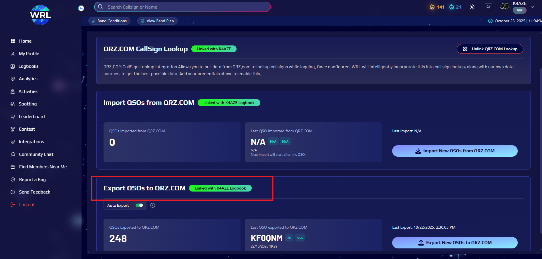

@KL5PF You need to click on the ‘Linked with KL5PF Logbook’ button under the Export QSOs to QRZ.COM section.
@K4AZE When I click on that button, this is what I see. I only have an option to select an import folder from QRZ, which is indicated as “inbound” in the dropdown.
@KL5PF Its just a verbiage error. If you click the green button that says ‘Linked with KL5PF Logbook’ under the ‘Export QSOs to QRZ.com’ and then select a logbook from the drop down and click save that will be the logbook that any of the QSO’s you log in that logbook will be exported to QRZ.
There are two places in the QRZ import/export integration. The import, where you select the WRL logbook you want the QSO’s from QRZ to be imported into and then the export, where you select the logbook you want the QSO’s in your WRL logbook to be exported to QRZ.
I’ll reach out to the team and have them change the verbiage for the export section to say ‘Select the logbook to export your QSOs to QRZ.com’ instead of ‘Select Logbook to import your QSO’s from QRZ.com’.
