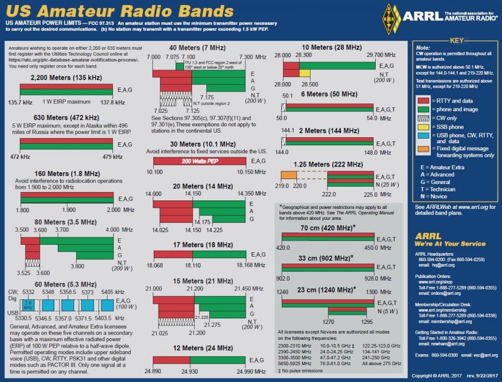

Which class of License do you have? A technician can operate on 10 meters. If you have a band plan that will help explain. Let me see if i can send you one.
I hope that helps. If you do cw(morse code) you can virtually do that anywhere.
I see, so with a tech license im only allowed to operate on a ten meter correct? I was under the impression that I could operate on a 6 and 70 also.
Yes, you are probably right. Just follow the band plan and you can’t go wrong.

… and find more infos about activity centers and calling frequencies in the official IARU Region 2 bandplan (which – in USA – supplements but does not override the ARRL band plan).
73 Pepe DL/HB9EVT

Also as others have said follow your band plan but I’ll also list your ranges that I recall.
Technician‑class licensees are granted full operating privileges on all amateur frequency bands above 50 MHz, which includes the 6 m (50–54 MHz), 2 m (144–148 MHz), 1.25 m (222–225 MHz), 70 cm (420–450 MHz), 33 cm (902–928 MHz), 23 cm (1240–1300 MHz), and higher microwave bands up through 275 GHz. These frequencies support all modes—CW, voice, digital, FM, even satellite and ATV—with up to 1,500 W PEP power as allowed by the FCC (47 CFR § 97.301(a), § 97.303(l))
Below 30 MHz (HF bands), privileges are limited: Technicians may use CW-only on 80 m (3.525–3.600 MHz), 40 m (7.025–7.125 MHz), and 15 m (21.025–21.200 MHz), with a maximum of 200 W PEP. On 10 m (28.000–28.500 MHz), Technicians may operate CW and digital modes between 28.000–28.300 MHz, and share voice (SSB) and CW on 28.300–28.500 MHz, also up to 200 W
