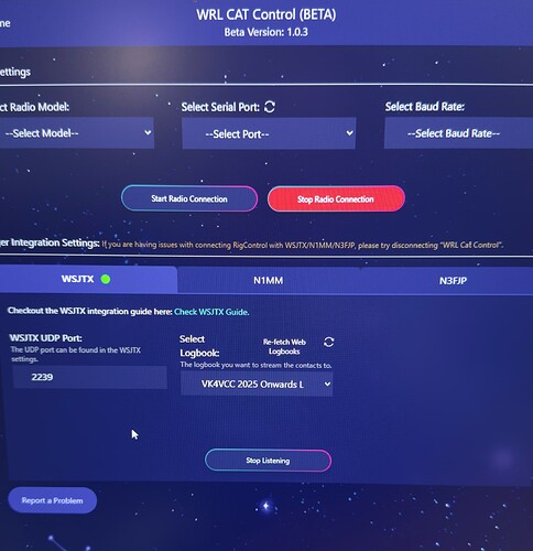

Good afternoon from VK4. I was hoping with the new video by Andy on linking WSJT-X with WRL was going to solve my problem. Unfortunately, that was not the case. I am primarily a FT8/4 user with some SSB during contests and rare DX’ing. I have my setup just how I like it with the exception of WRL logging.
The QRZ integration has made my job easier but I would love for the WSJT-X integration to work and make my logging even easier.
My current setup and opening order is as follows - Grid Tracker 2 → LOG4OM2 → WSJT-X → JTAlert2 for WSJT-X.
In the WSJT-X UDP Port (above) I have tried all combinations without any luck. My software ports are as follows;
WSJT-X - UDP Server - UDP Server Port Number : 2238 (All boxes ticked on right)
Grid Tracker 2 - Receive UDP Messages Received from WSJT-X - Port 2238. Forward UDP Messages (eg. Grid Tracker on Another Host) - Port 2239.
LOG4OM2 - Connections - UDP Inbound Connections - [UDP_Inbound][JT_MESSAGES][2238] Grid Tracker; [UDP_Inbound][JT_MESSAGES][2239] Call Info; [UDP_Inbound][ADIF_MESSAGE][2236] Grid Tracker; UDP Outbound Connections - [UDP_Outbound][ADIF_MESSAGE][2237] Grid Tracker.
JTAlert - ADIF_MESSAGE Port - 2240; Control Port - 2241.
I have both QRZ.com and HRDLOG.net setup for automated logging through LOG4OM2.
If anyone can understand where my problem lay, I would love to be able to fix this and get the logging solved.
