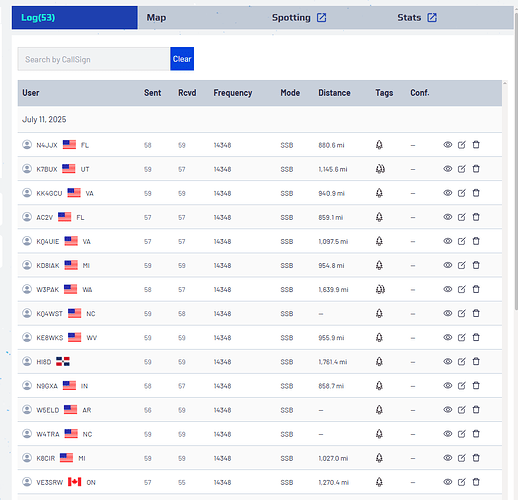

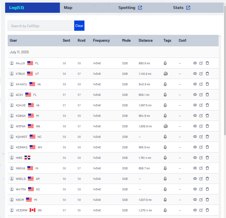

When displaying the list of QSOs the band information is not on the list. For various reasons, the band stops replicating when logging QSOs. This is the most common error in rejection of my POTA uploads because I can’t see it on the log list.
Please add it to the log list when you click the log and it displays the QSOs.

The band and mode are set when you enter the frequency, as long as if you are entering the frequency in megahertz. We have some changes coming that will help users know which contacts are missing information when exporting their logs for POTA. For now the best way to update this is to use the web app and goto ‘logbooks’ and then click ‘QSO Manager’ and then select the contacts you need to add the band on and then bulk update the band and save it. Then just re-export your log and upload to pota.
I hope this helps.
