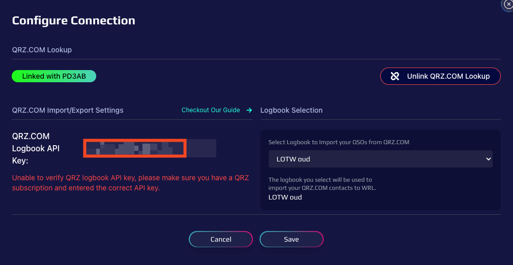

Hoi all,
In the integration option, when I try to export to QRZ.COM, it doesn’t work. WRL keeps giving an error saying the API is incorrect or something similar.
I’ve already copied it 1:1 and also tried entering it manually, but the error persists.
How can I fix this? I know that I can only use the “Export to QRZ.COM option, and that’s exactly what I’m trying. (login en ww are correct checkt them severaltimes)
What am I doing wrong?
kind regards
Andre
@PD3AB Hey Andre,
I just looked and it looks like you don’t have a QRZ subscription so while you have your QRZ API key added from your QRZ logbook correctly, the QRZ free account doesn’t have the ability to auto import contacts.
I hope this explains why this is happening.
Hey Andre @PD3AB
At least you need a XML Logbook Data Subscription at QRZ:COM.
Tot ziens
Pepe
should add a warning in when add key that tells you need a paid subscription for work so we :stuck_out_tongue:
