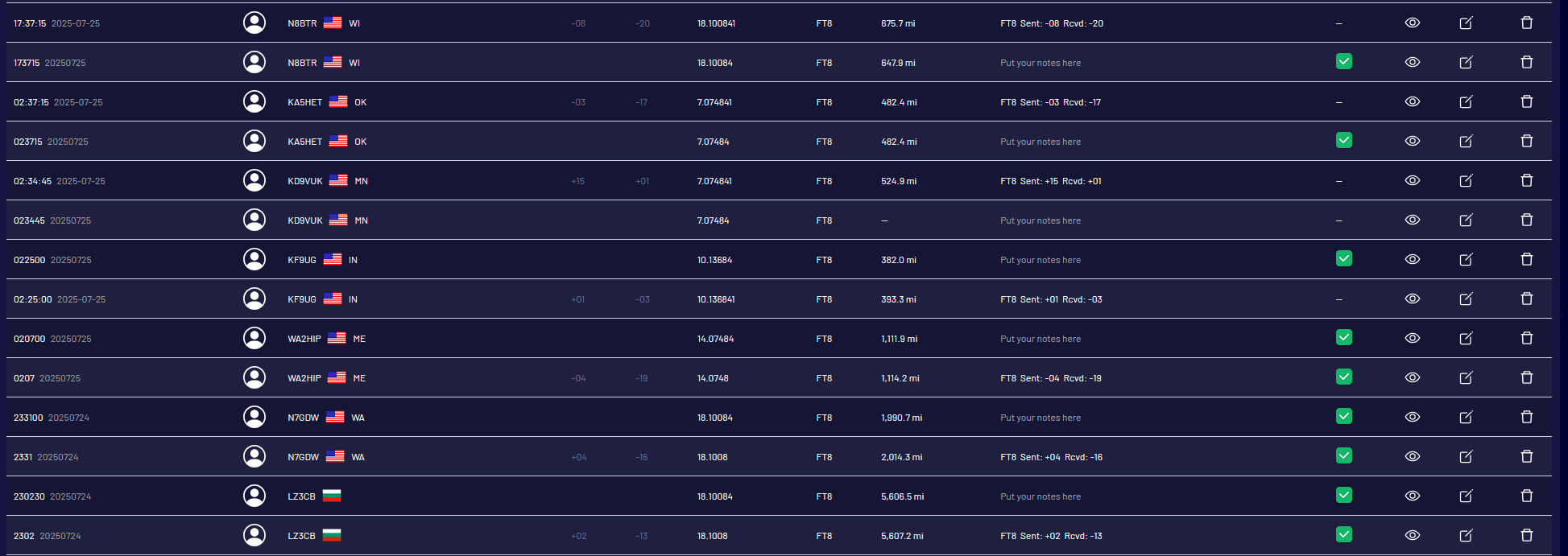

I tried out the QRZ and LOTW imports yesterday and it looks like one of the two is duplicating entries. See the screenshot below:
It looks like the import may not being handling a formatting difference for date/time. Unfortunately I don’t know which of the two imports caused the duplication.

@KQ4SFG Hey Alex,
This should not be happening, im wondering if its because one has RST information and the other doesn’t and the frequency is off by a digit. Will you go into WRL and click the bug report button and submit a bug report. I’ll reply with this screenshot. That way we have a ticket for it and we can address it properly.

Hey there! New user here. This same thing just happened to me. Imported qsos from qrz.com, then also from LoTW. It duplicated everything. It’s important to mention, that all my LoTW entries are directly uploaded from qrz.com, so there should be no difference.

@HA1RY You’ll need to create a bug report via WRL. Go into WRL and click the ‘Report a bug’ and then i’ll reach out through the ticket and we’ll start to dig into it.
