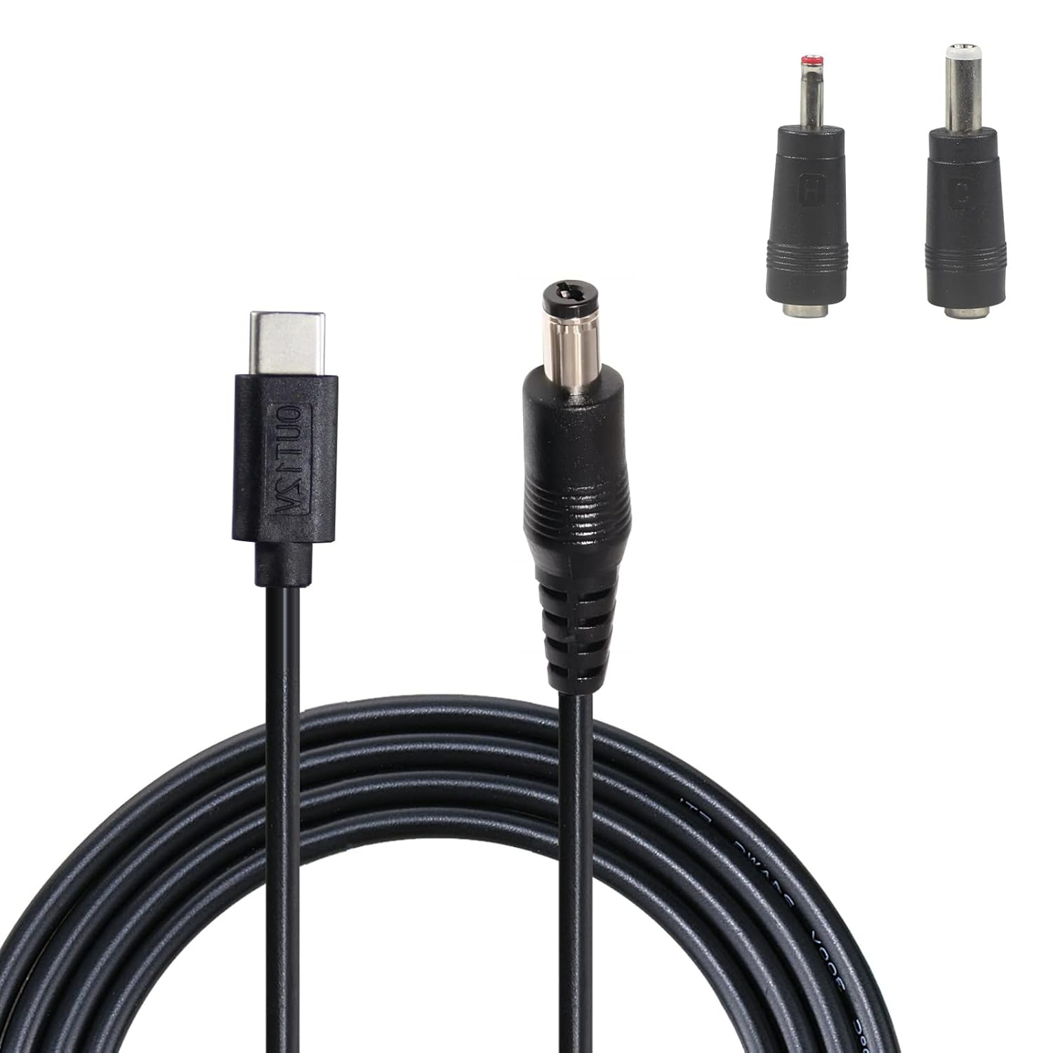

USB-C in it’s Power Delivery (PD) incarnartion can supply a variety of voltages including 12v. You’ll need a “12v trigger cable” (Amazon) to get a USB-C PD supply to deliver the right voltage. They usually terminate in a barrel connector that you can adapt to the G90 input. The G90 won’t take 100W on transmit but you should allow for 40W if we assume that it’s 50% efficient. That’s less than a laptop would take from a USB-C source when charging.
This one will do 36W -
