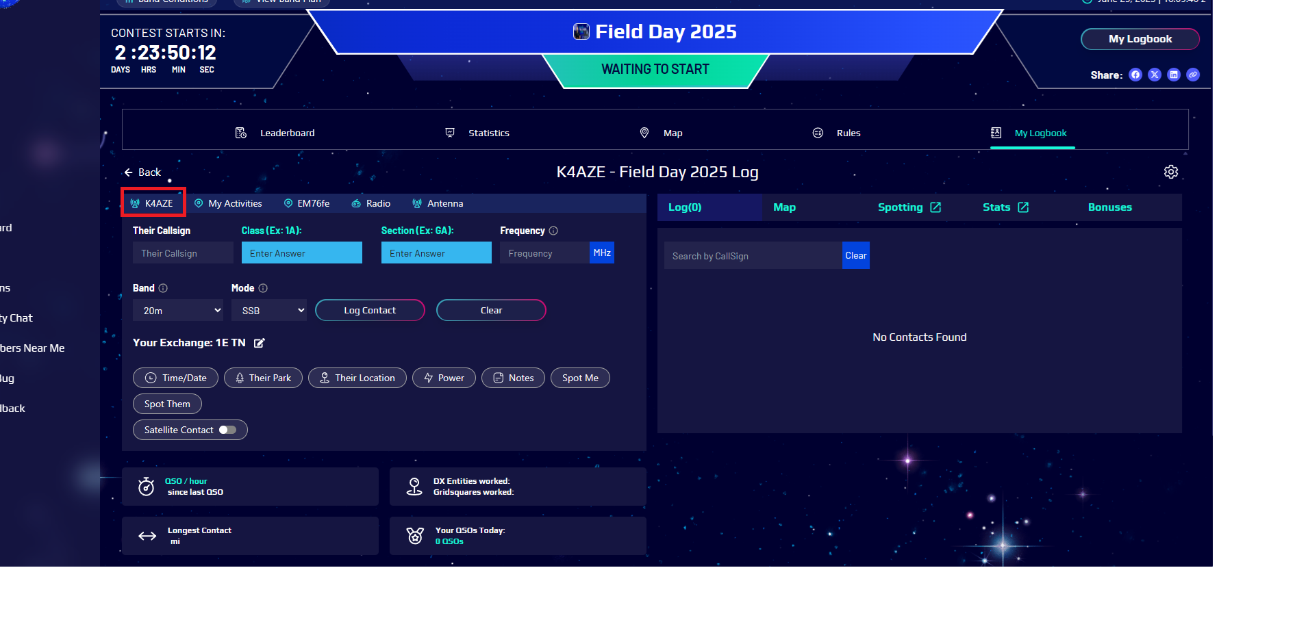

@WA5WRL We are finalizing some changes that you will have available (should be in the next couple hours) before field day starts that will give you the ability to create a club account, share the login details, each operator logs in using the club login and then you set your operator call in the logbook. This will export with the operator callsign.

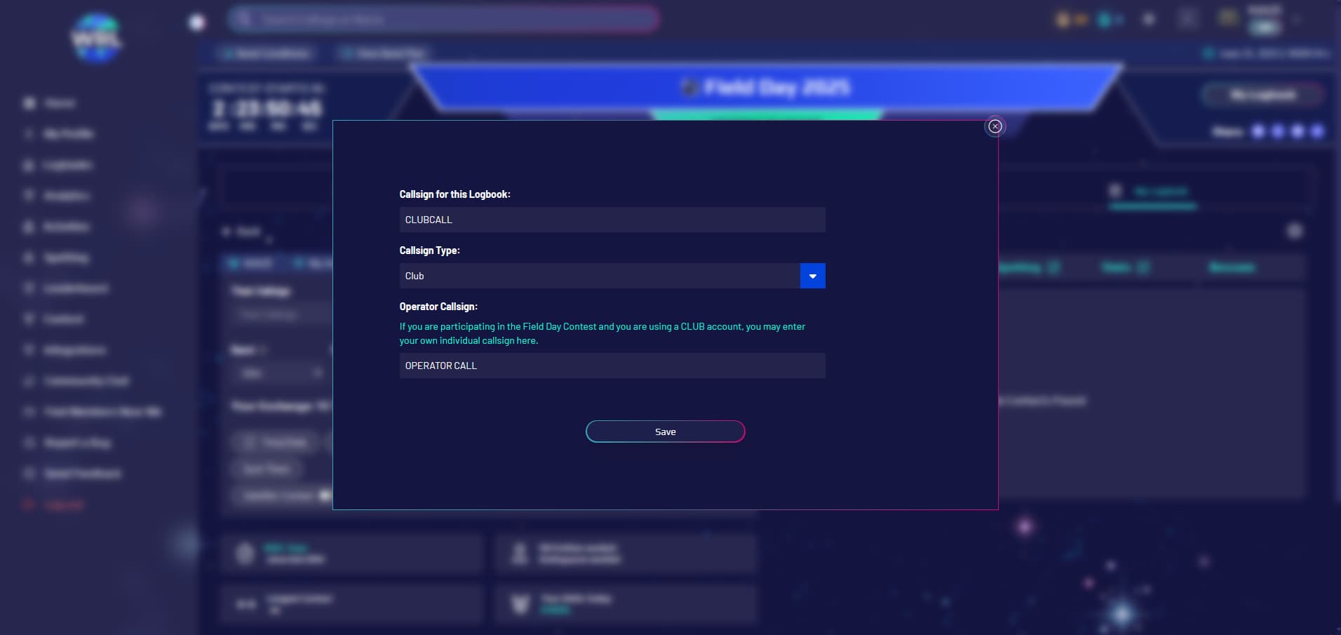

Once logged in under the club account you’ll go into the logbook and click where i’ve highlighted in red. Then you’ll see the options in the second screenshot. I would also say make sure you go into the logbook settings (with the logbook open click the gear icon in the top right) and make sure you’ve set your contest settings and other settings as well.

Brad, I’ve just filed a pair of bug reports about this, but I’ve found that the operator is not reliably saved when I click on the club callsign as shown in your screenshots. It is only saved consistently when I click on the gear icon in the to right of the log title and edit the log settings. Sorry to have to report that! ~~Tony
