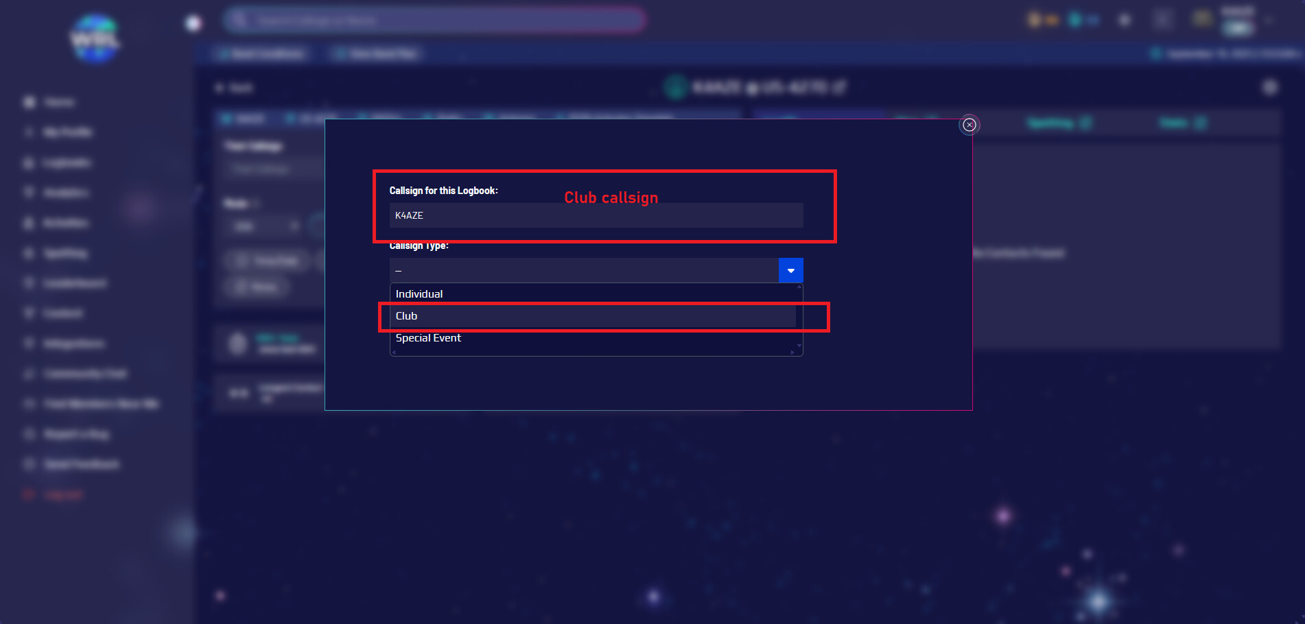

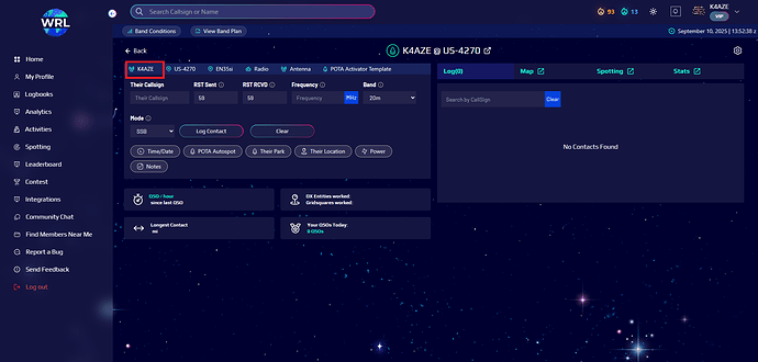

You certainly can! What you would do would be to first create the logbook for the pota activation (setting the park, making sure the location is set properly, etc) then you would go into the logbook and click the callsign above the ‘Their Callsign’ field (see screenshot 1) and then update the ‘callsign type’ to ‘club’ (see screenshot 2) and save those changes. Then you would have each operator log into the club account and open the newly created logbook and make their contacts. Once your ready to export the logbook you can goto the logbook settings and goto the ‘export’ tab and then under the section ‘Export Log For Another Operator’, (see screenshot 3) enter the callsign of the operator you want to export the log for and click the ‘Export US-XXX.ADIF’ button.
