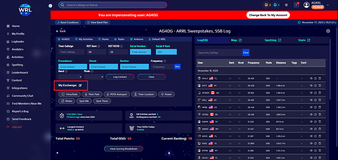

@W7YBY I just looked at your logbook and you dont have your exchange information added. Go into your logbook and click the button next to ‘My Exchange’ and then add your correct exchange information. After that is done then just re-export your cabrillo log.
For each contest you’ll need to add the ‘My Exchange’ information before exporting your log.

I feel stupid. I have the same issue and can’t find or am looking wrong for “My Exchange” and the button. I’m in my logbook and can’t figure this out. My first ever contesta also,
Thanks, Doug AG4DG
@AG4DG its right underneath the logging fields.
Thanks! My mind filtered that as a heading, didn’t even think of it as a field. Thank you for helping!
