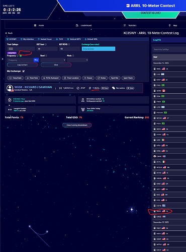

Dupe checking inconsistant
Trying to figure out why the “dupe” didn’t appear on this contact.

Another example:
@KC8SWY where it shows ‘1 QSO’ doesn’t mean that callsign is in this particular log, its looking across of all your logbooks. However we are aware of an issue that if the mode is SSB and you make a contact with the same callsign and the mode is USB or LSB it will still not detect it as a dupe, we are fixing that.
Same log book, same mode. You can see the dupe circled on the right side. It’s inconsistent for some reason.
I figured out the issue. It doesn’t report the dupe when the frequency field is blank. Once WRL Cat control 1.0.8 comes out, this should solve itself.
@KC8SWY Did you not enter a frequency or did it not come over from cat control? Because yes its using the freq to check the dupe against.
Didn’t come over from CAT control. There is a bug with the 7610 and V 1.07 that is being worked on.
