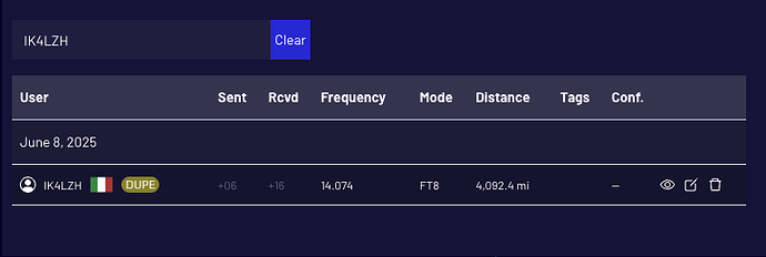

I think I may have found a bug! While cleaning up my logbook for the ARRL Digital Contest, I noticed that after deleting duplicate entries using the QSO Manager, the original callsigns still remain flagged as duplicates — even though the actual duplicate entries have been removed.

@W2DIY Hey Daniel,
How were you deleting the contacts in the qso manager to get the dupe tag to stay? Did you do a bulk delete or just delete one of the dupes individually ? We’ve checked into this but were unable to reproduce it.
@K4AZE I went into the QSO Manager, and would hand select the QSOs I wanted to delete (out of the dupes) and the bulk delete the selected ones. I favored keeping the QSOs with the best signal reports just to know that the QSOs will be confirmed.
@W2DIY This is VERY helpful.
Thank you!! I’ll pass this info along and we’ll try and replicate it doing it this way. I’ll update you shortly
