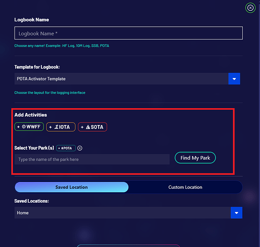

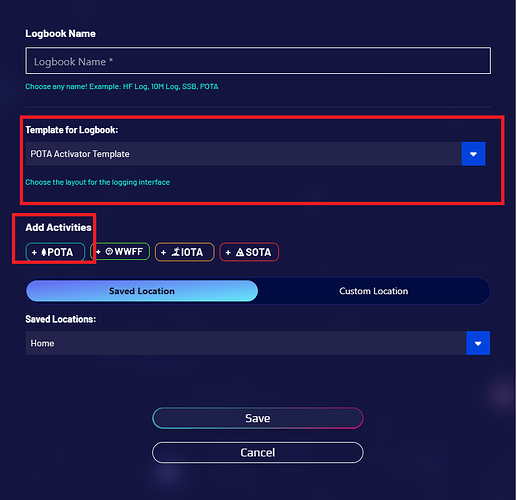

So what you’ll want to do is create a new logbook and make sure you set the logbook template to the ‘POTA activator’ template and then set your logbook to the POTA activity and enter your park information (see screenshots). This is the same on the web app and the mobile apps.
Once you’ve done that and have logged your QSO’s you’ll want to goto the logbook settings (the gear icon) and click the ‘Export US-XXX ADIF’ button, this will export your logbook with the proper fields that POTA needs when you upload your logbook to them.
