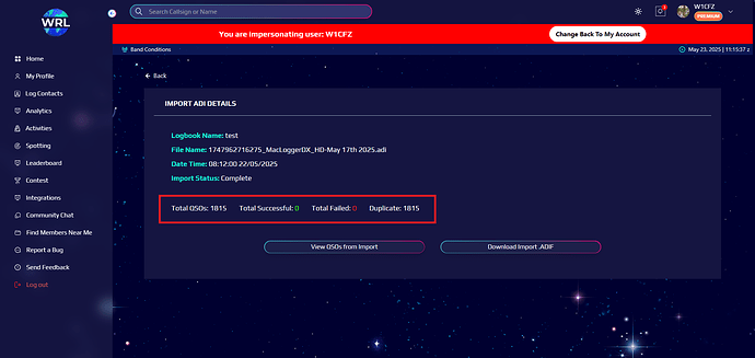

So I checked the ADIF and it looks correct. I took a few of the qso’s out of the log and tried an import in your account they import properly but they are duplicates. So then i went and looked at the import you tried to do 10 hours ago and its showing that all these qso’s in the ADIF are already in one of your WRL logbooks. You can confirm this by going to ‘Log Contacts’ → ‘QSO Manager’ and then searching for a callsign that is in the ADIF.

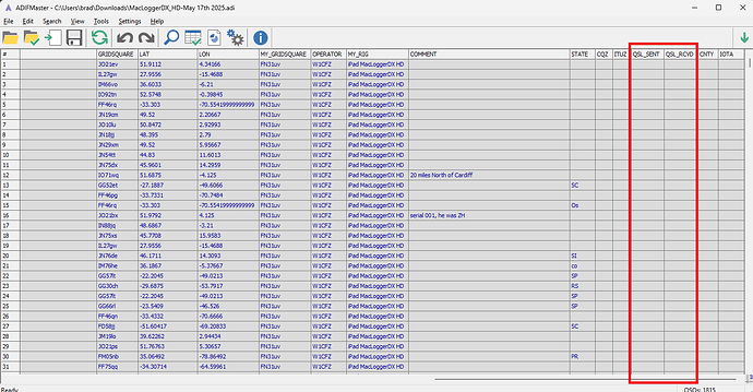

Currently we don’t have the QSL Sent/RCVD setup in the logs since we are in the process of building out our QSL card generator/page. It will be a place for users to create their own custom QSL cards and not only generator a pdf but we’re going to have a way users can have the QSL cards printed and mailed all through the WRL app. Although in your adif file you sent from macloggerdx, it doesn’t have data in those fields either so technically if we did have the fields in WRL it wouldn’t have came over because there’s no data there. (see screenshot)
