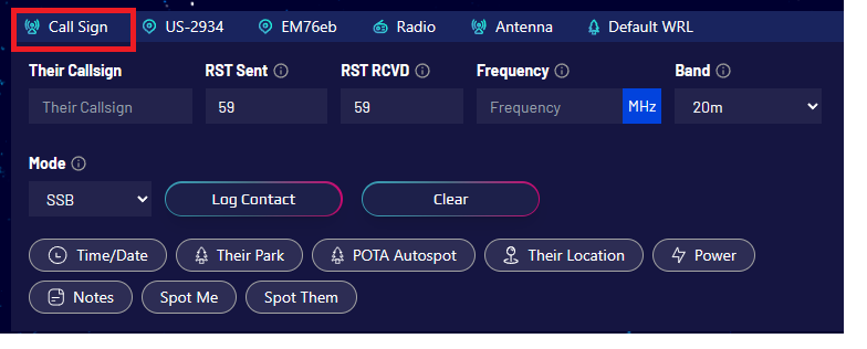

Currently I don’t think so, you can however set your club call by clicking your callsign above the ‘Their Callsign’ label in your logbook:
Then set the ‘callsign type’ to club and update the callsign for the logbook.

Just a question on Operator Call sign, If we have mutli operators during the same event. If i switch Operators during the event, will this keep with the contacts they made or is this a global switch requiring a new logbook for each Operator? I will be operating W1AW/8.
@AC8HZ Inside the logbook click on the callsign in the quick settings bar above the main logging fields, then set the operator to whichever operating is making contacts and logging. (see below).
